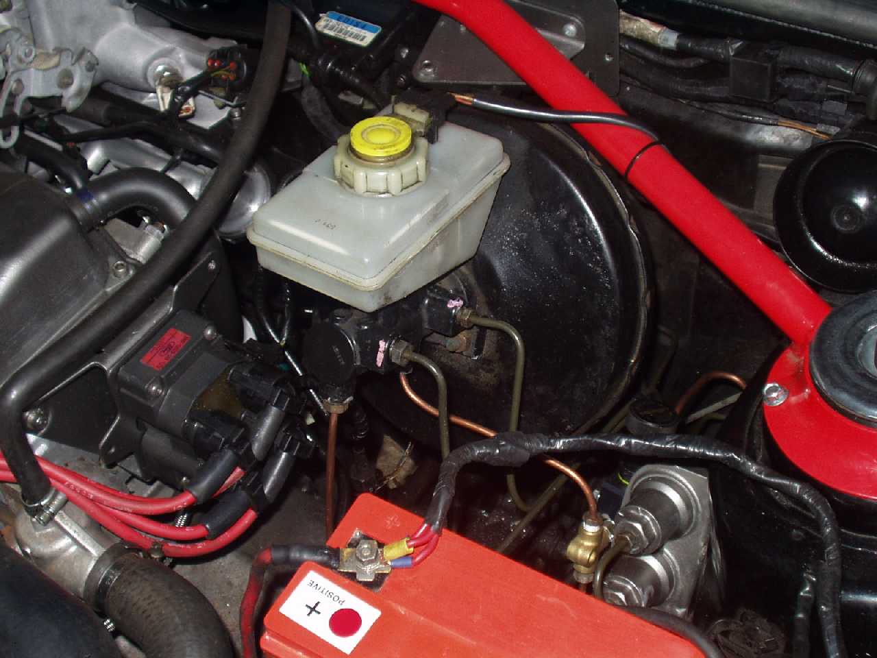

Postby sjh on Mon Apr 07, 2003 3:46 pm
ive got piccies of my master cylinder conversion but do not know how to get them into a post they are uploaded into my gallery.

Postby Project on Mon Apr 07, 2003 5:03 pm

Postby unknown_user on Tue Apr 08, 2003 10:48 am
put that battery in the boot?

Postby Stoned on Mon Sep 08, 2003 7:25 pm
You need the pin on the end too like this
And as far as sjh's instructions go, yes you drill into the mount and not into the servo. If you did I think you would find it might not work too well
