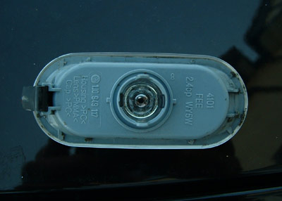

Wiring wise it was easy enough to buy the VW wires and rubber clip that clip onto the back of these things. Come in a nice box with a cover too (oooooh). Crimped and taped up the connections, note the bodge and they plug in nice. And i haven't had any condensation either FezzR Below you can see how strange they are on the back, there is only a slight flat lip on the edge.
