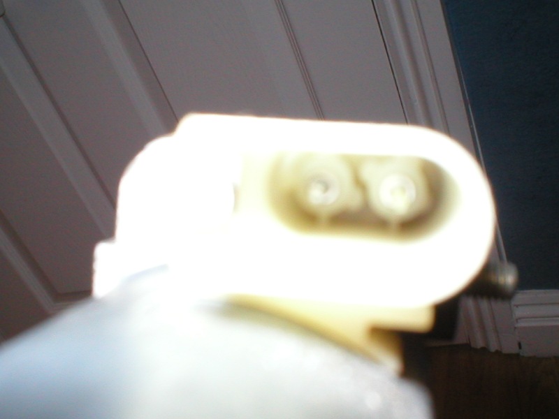

· Hopefully you will have the other side of the plug which attaches onto the side of the motor.
From this there will be 1 blue and 1 green wire. Feed these through the door loom (if you manage to get them through the original rubber grommet thing.....well done!).

pictures now added [ERRR] b clearer for u all now! Hope ur car is ok Jay m8!
dave

yeah! I had loads of problems tryin to get hold of a wiring loom! Ford wanted about £37 per side so i made my own!! Just use some 10amp wire from halfords!

the waires aint a problem its just the connecters that fit to the motor. spade ends are fine on the buttons but on the motor its just little metal sticks but dont know how to connect the wire to this? can anyone help with this??

Clean the metal connectors off and scratch them up a bit with wet and dry, then solder the wires on directly
