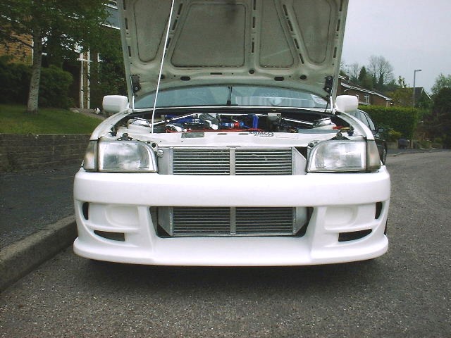

curious on the cooler tho single pass?? also you not think on going a slightly thicker core?? surely with a thicker core there would not have been such a need for the size??? i always got told the thicker cores were better than the thin ones as it coolers the air better
just curious
pic of mine below as you did speak to me before about my system its a 63mm thick core unsure on the height and length its been a while but the act's are LOW

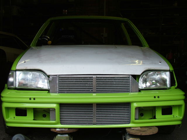

Regarding Paul's cooler...as long as it doesn't give higher charge temps or increase the pressure drop, it's worth it. It all depends on the cores and end tanks

heeman10 wrote::Regarding Paul's cooler...as long as it doesn't give higher charge temps or a lower pressure drop, it's worth it. It all depends on the cores and end tanks
Yes but it makes more work for him with little (if any) improvement/ effect, as the car came with a GRS fitted.
This was proven to handle it & no doubt would still do the biz for a long while yet!
Oh and then theres the pipework routing which needs to be changed. I would have thought it to be easier all round to turn the GRS into a single pass!

More work for little effect? That's the basis of motor sport and performance improvement matey
Running the GRS core as a single pass would probably be a bad idea and result in significantly higher ACTs.

heeman10 wrote:More work for little effect? That's the basis of motor sport and performance improvement mateyRunning the GRS core as a single pass would probably be a bad idea and result in significantly higher ACTs.
Sorry but doesnt the bonnet block the EXTRA part of that intercooler? So in theory a wasted effort.
The GRS had more surface area exposed.

Oh and we looked at mounting the GRS lower down (even had the pipes re positioned by Graham) but it was far to low for my liking..........
One 'off' on track & its would be buggered!
Still think its overkill esp if said engines staying the same!
