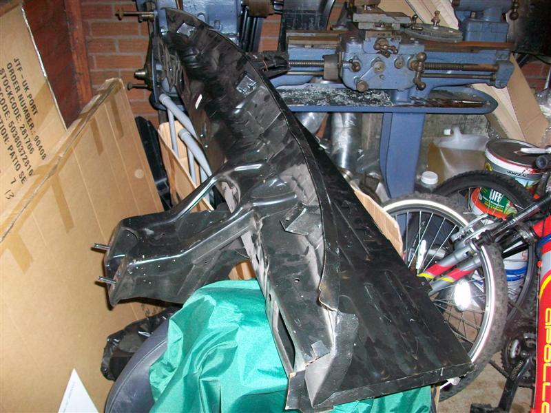

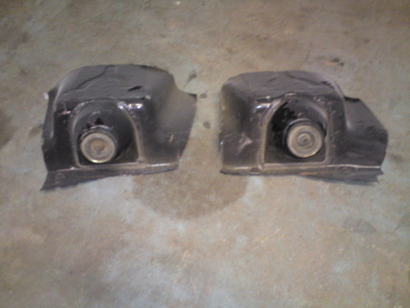

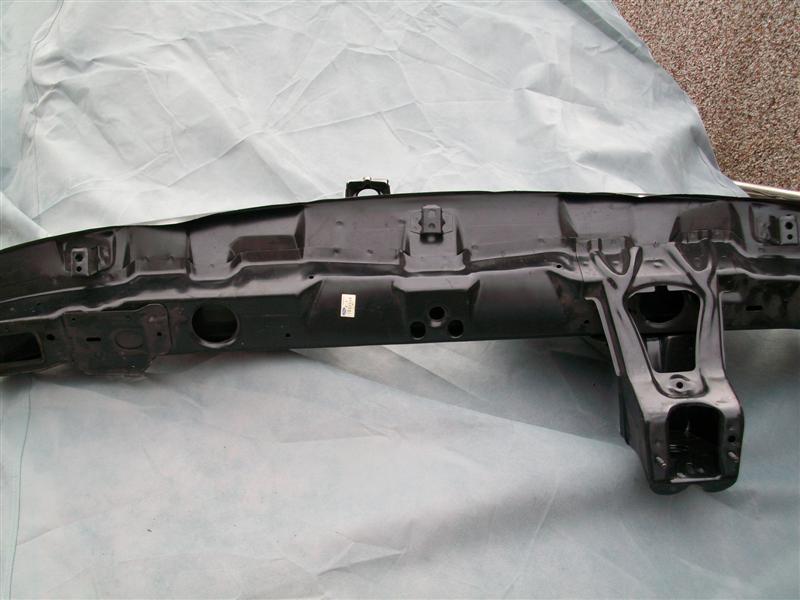

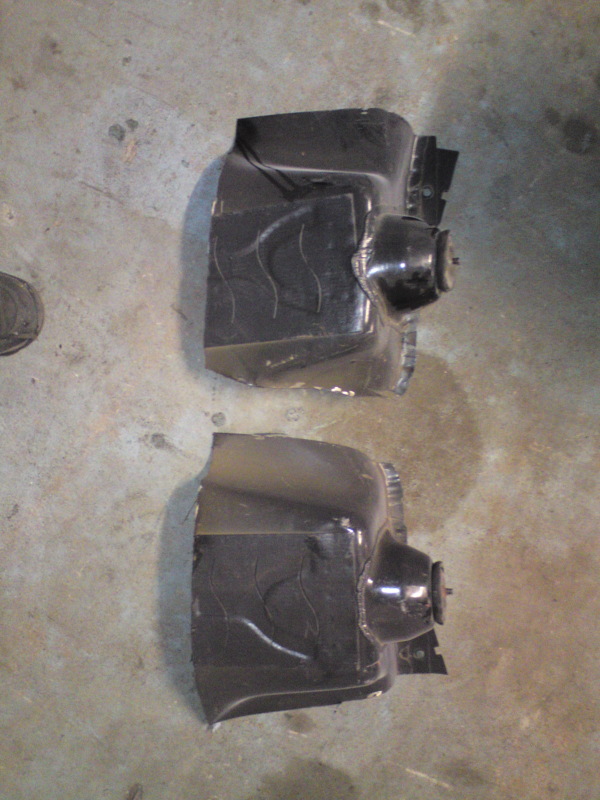

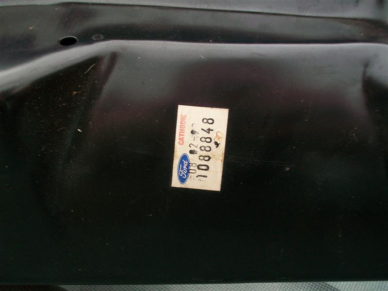

The inner arches were from my local bodyshop supplier, they are pattern parts.
Part of the Mk3's deisgn which I find absurd is the sunroof drain locations - why drain water into the most vulnerable area of the car, where 3 sheets of metal are spot welded? I have run each drain out and clear of the sills:
Panel alignment:
O/S now complete:
I got this far on the N/S:

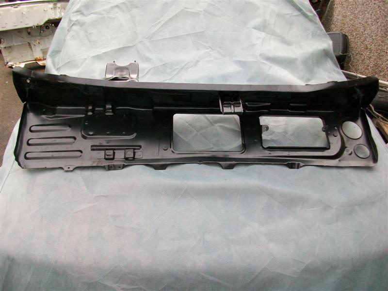

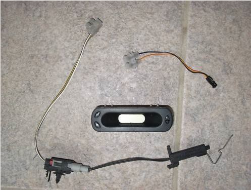

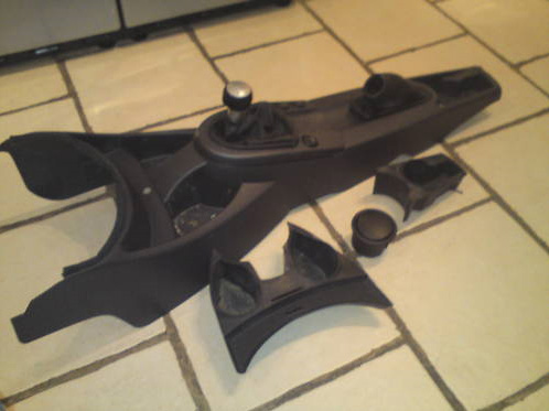

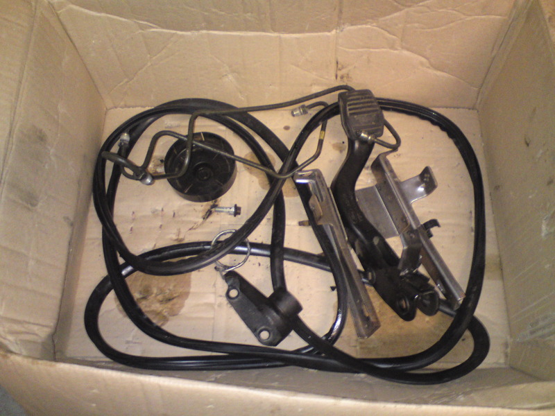

I had repaired my back panel but decided to order a Mk5 back panel and reinforcement, just in case there's anything hidden in the seams. This weekend should see the outer panel work finished once and for all, and maybe see the application of some primer!
I now have a Puma dash and A/C Airbox, and I'm keeping my eye out for a low mileage Escort Zetec engine from which I will take A/C pump & brackets/Alt/Pas pump arrangement (front cross member will be modified slightly for this). XRSi is cutting out a Mk5 Bulkhead for me so I can fit the Puma dashboard correctly.

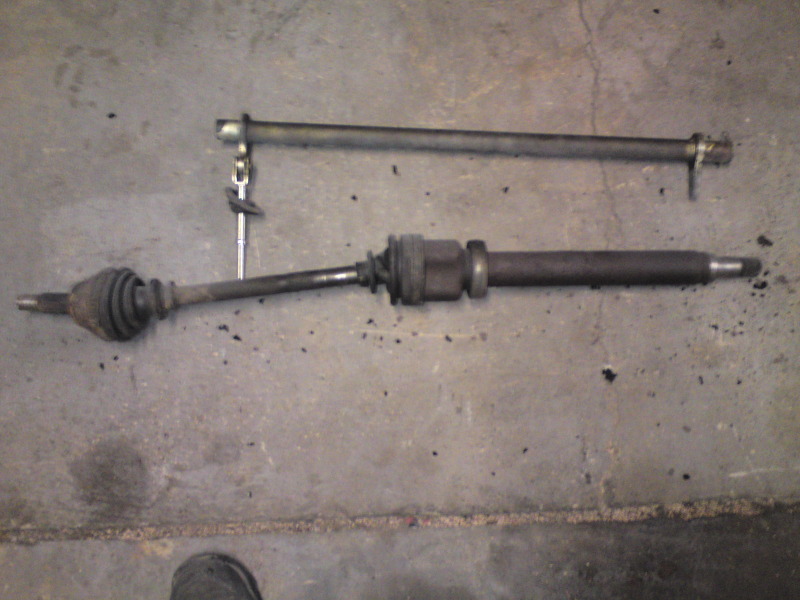

I have these sitting on my desk today:
Mk4/Mk5/Puma (Fiesta DX) front strut top inserts. I'm going to drill out the Mk3 turret inserts and weld these in, front and rear (xrsi is cutting out the rear turret inserts from the same ZS as these aren't available separately from Ford). The strut tops are a massive weak point on the Mk3 - even Poly bushes can only limit the amount of deflection so much; I had considered comissioning a pair of machined cups to fit around the base of the front mounts when fitted, to prevent deflection, but even then the car would be compromised. The Mk4/5 tops are superb so will give be a quieter ride and much less geometry change. I'll be running Sport Ka front hubs (I'm fitting ABS), and Zetec-S struts.
I'm also waiting for an equal length drive shaft from a ZS, to further improve handling.
I have a full Zetec-S loom that I got from a year old car back in '02 - this was destined for the 'quattro' car but obviously no longer required! I will fit this to get remote locking and the A/C wiring (which is easy enough to wire up anyway) and switchable ABS/TC. I have a spare EECV ECU from which I'm going to chop off the connector and make a plug and play EECV-EECIV connector lead so I can leave the ZS loom largely standard.
As my 2.0 EECIV ECU is from a Mondeo it already runs code for ECU-based control of two primary cooling fans and 1 A/C fan. The ZS loom has this wiring present which will save me time! In the engine bay, I'll modify the (all black) plug-in engine loom to suit the Zetec-E. This way I maintain the main EECV wiring so I can plug in a standard ZS engine loom whenever I want in order to fit a Mk1 Focus RS Engine and run it from EECV with relative ease.
EECV PATS is internal, so PATS wiring will be removed from my Si loom and integrated into the ZS loom. I already have the matching key for the ZS GEM so the remote locking works, and I had a key blank cut to match the Si. I've yet to see if the Mk3 PATS Key transceiver fits inside a Mk5 remote locking key, but I don't anticipate any big headaches.

Postby Excursion on Wed Aug 04, 2010 6:20 pm
Thanks Jon :)
Thanks to STOKE7UP I will now have a Genuine Ford Mk4/5 upper Bulkhead panel, so I can correctly fit the Puma dash, wiring and heater box/pollen filter.
I changed my mind regarding the centre console layout - I was planning to use a Midnight Black (phase 2) Mk5 console and mounting the Mondeo TC button above the Mk5 tailgate release button. I'm no longer going down this route and instead I just bought a complete ST170 centre console with TC and heated seat buttons, along with an additional Focus gear gaitor for the ib5 type gearboxes (non lift-up reverse).

Postby Excursion on Mon Aug 09, 2010 10:06 am
Thanks to tompetRS for some Focus Mk1/1.5 wiring diagrams.
xrsi has taken some pics of the parts that I'm buying from him.
Mk5 rear turrets:

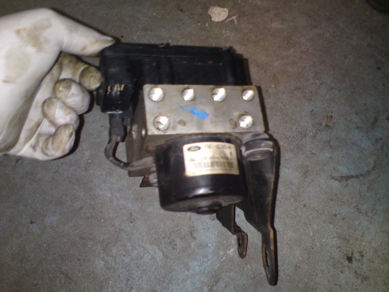

ABS/TC module
Equal length drive shaft:

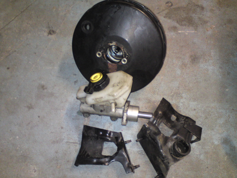

ZS brake servo, brake pedal and link bar - I have a suspicion that the Pedal ratio is higher in the Mk5:

My temp clock:
