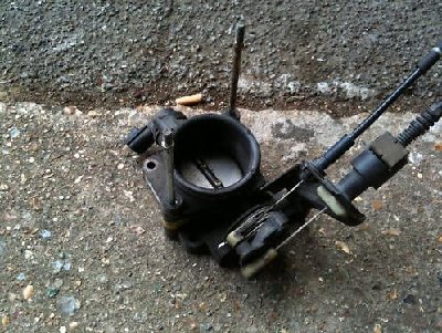

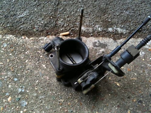

Sadly no DBW; that would be really nice! The EECIV and EECV Zetec's used a second cable from the TB, linked to a Servo module.

I discovered that the ECU in the Zetec-S is some kind of half way house/cut down EECV. It still uses the old EECIV 60 pin connector, rather than the new 104 pin EECV connector. Focus Mk1 & 2 2.0 Zetec are the same.
Mk1 Focus RS uses the full EEV 104 pin type ECU. Focus RS Engine was my plan, so I'll need to have a think about the Zetec-S loom some more.

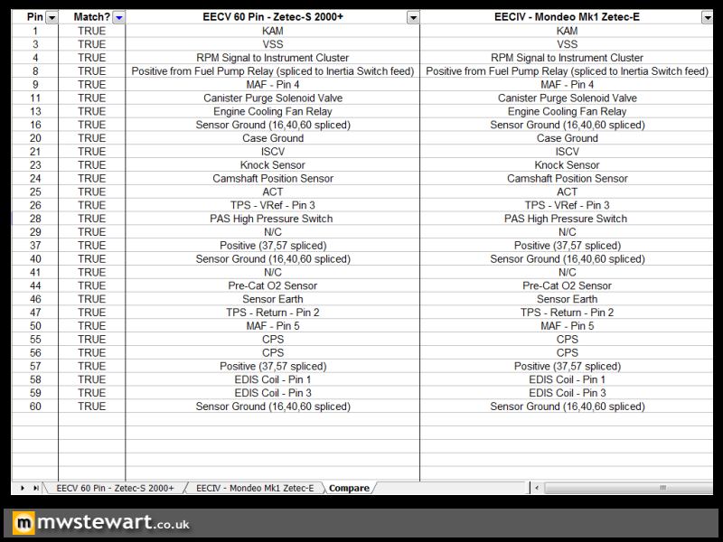

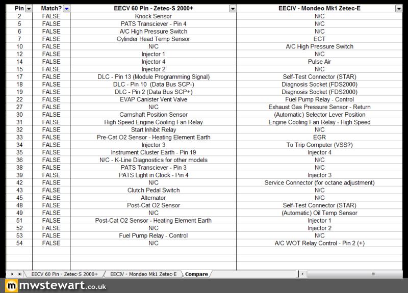

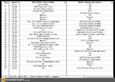

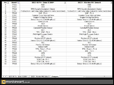

I have done some analysis of the the Mk1 Mondeo and Phase 2 Zetec-S Wiring Diagrams:
I'm a bit gutted that the Zetec-S only runs the 60- Pin EECV ECU because I wanted to perform the majority of wiring prep work now to support a Focus RS Engine on EECV (aftermarket management just doesn't compare IMO). At least the ZS does run the SCP bus, which will enable me to fit some more interesting instruments at some point, and get some data logging on the go.
Looks like I need to find a 104 Pin FRS Engine bay loom for when I do get the FRS Engine. I missed a brand new one a few days ago for £44 not realising at the time that the ZS only had 60 pins. Doh!
For now, the main priority is to use the ZS loom to run the Series 1 2.0 from EECIV, which can be done quite easily. The ZS engine bay loom just unplugs from the engine bay fuse box anyway, so it's not a major project to take it out and modify it later on.

I will have a EECIV 2.0 ECU (I think it's DEEP) and MAF that I won't need, as I'm replacing with the EECV (OWLS for example) - this won't be for a couple of months, though.

It looks good to run the Series 1 from Series 2 EECV management. The Focus used the 60 pin ECU and the pin outs for this are near identical to the Zetec-S, which is great.
The only pins that aren't are knock sensor (Zetec-E 2.0 didn't run one, so this can be ignored) and instrument cluster feeds: the Fiesta Mk5/Puma instrument cluster uses wires for each warning light and dial, where the Focus uses the SCP bus to drive everything, so I need to test a Focus ECU to see if it's still programmed to output the individual RPM and ECT feeds (speed comes directly from the VSS).
Mk1/2 Focus manual's all ran 60 pin EECV. The only exceptions are ST170, RS and Automatics.
All Mk2 Mondeo's ran the 104 pin ECU, so this will be a cheap way to get a Focus RS compatible loom.
