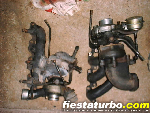

When Ford released the Fiesta RS Turbo in 1990 they fitted the smaller T2 turbo rather than the Escort's T3. The smaller engine bay of the Fiesta meant that the Escort turbo wouldn't have fitted between the block and the radiator. This is the first obstacle to overcome when doing the swap. This will be explained in detail later. The conversion require a number of parts from a donor Escort or parts supplier. There are a few alternatives in certain aspects of this, such as the downpipe arrangement and oil returns. Some Fiesta parts can be modified and re used such as the cone filter if fitted.

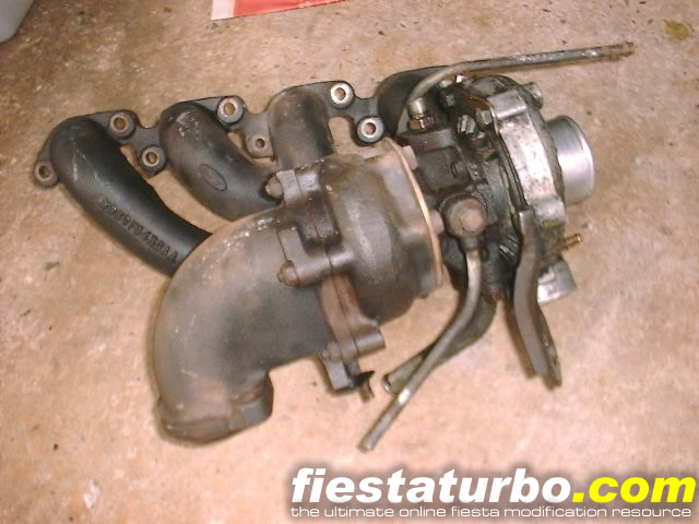

Undo the exhaust studs on the head and lift the turbo off the engine. If the T3 isn't already bolted to the manifold and elbow, connect it now. Position the T3 over the studs and tighten to the specified torque settings. Fit the actuator but leave the rod disconnected from the wastegate, we'll set the boost later.

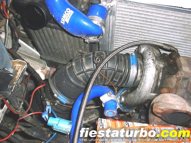

Oil feed and return
Screw the braided oil feed pipe into the block, the block end is the one with the slightly longer metal L bend before the braiding. Route the pipe round over the gearbox side of the engine taking car to keep it away from rubber pipes etc. Position it near to the top of the turbo but don't connect it yet. Fit the oil drain return pipe and then use the rubber oil return pipe to join the drain pipe to the threaded boss on the block by sleeving it over each one. Use hose clips to tighten the seal, making a mental note to tighten them again after running the car the first time, when they have softened with the heat. This will ensure a good, tight seal. Another method is to remove the threaded boss from the block and use the Escort fitting which is just a push fit.

Boost hoses

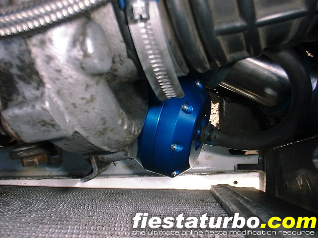

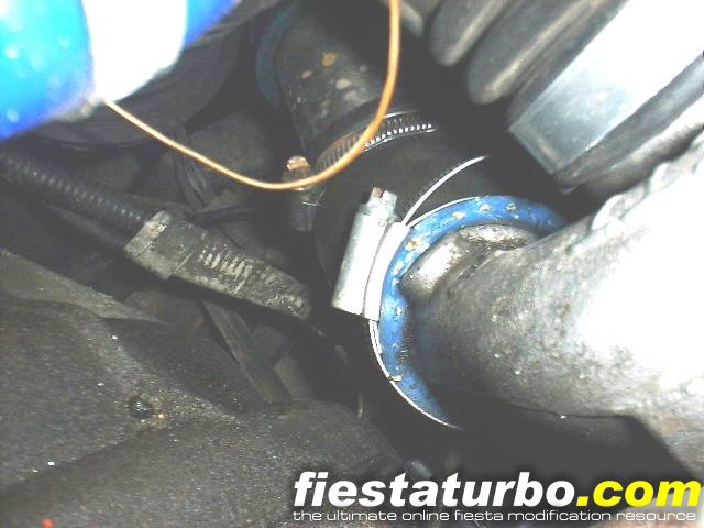

The existing charge carrier (T U R B O pipe) to intercooler hose is fine but the turbo to intercooler outlet on the T3 is in a different place to the T2 so a new
pipe work arrangement is needed. Take the 45 degree bend that connected the turbo to crossover pipe and cut this into two pieces so each will provide a 45 degree bend
rather than the full 90. Detach the intercooler from the radiator and position it in place with the mounting foot on the base resting on the front
cross member, forward from it's accommodating recess. Use the 2-3" metal pipe, or a similar length cut from the crossover pipe, in
conjunction with the two 45 degree bends to connect the intercooler outlet to the turbo. It's usually trial and error with the length of the pipe to obtain a good fit.

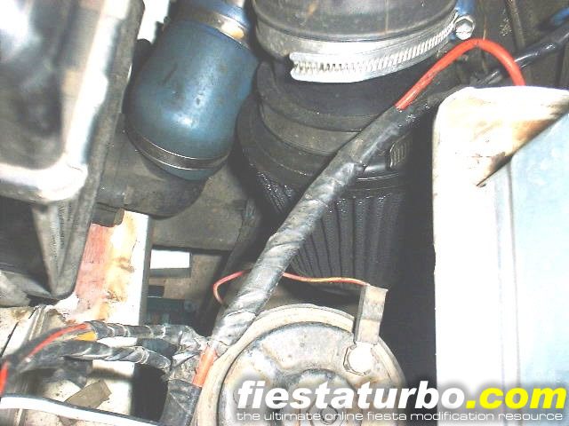

The FRST cone filter can be re used. Take the air filter to turbo hose and cut the bottom right angle off it to leave an L shape. Trim it back so the narrower end sleeves over the turbo then hose clip this in place with the filter pointing down towards the gearbox cradle. A preferable
arrangement is to relocate the battery to inside the car then use a straight hose to position the air filter where the battery was. This reduces it's
susceptibility to dirt and water.

On our project car we used the original Ford hoses to avoid cutting up the Samcos. The car will be fitted with a different intercooler shortly and had we been continuing to use the standard unit we would have used the Samco hoses.

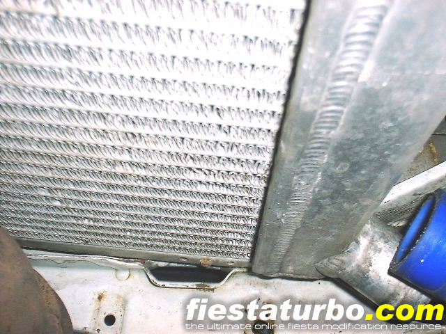

If the radiator is left in it's original position the actuator bracket or actuator itself will be either touching the radiator or very close and likely to make contact when the engine is running, damaging it. In order to eliminate this possibility the radiator and intercooler need to be moved forward by approximately an inch. There is some variation here depending on the car, and also the turbo and actuator used may provide less or more clearance depending on their design.
Undo the hose clip connecting the intercooler to the bottom hose and attach the intercooler to the radiator. Position it in place but with the locating feet at the bottom moved forward of the retaining recess in the
cross member. This will position the two at an angle and should clear the actuator bracket. If more clearance is needed it may be
necessary to cut a notch out of the vertical panel by the headlight, where the turbo water feed is taken from the radiator. Cut a notch to allow the radiator to be moved forward without the water takeoff fouling the panel. Repaint any bare metal to avoid corrosion. Remove the inner rubber washer from the slam panel mounts to allow the radiator to be secured nearer the front. Reconnect the intercooler to the turbo and charge carrier pipe.
Maximum clearance can be obtained by mounting the radiator at an angle with the intercooler sat slightly behind it. This is at the expense of visual appearance though and can look odd. A happy medium can be obtained by experimentation.
