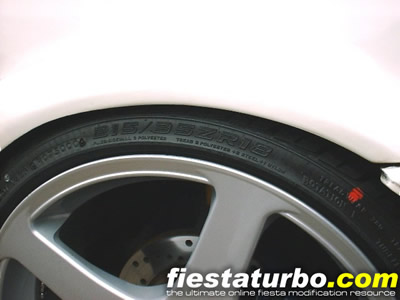

The most popular size of wheel to upgrade to is 15". This size combined with 195/45 profile tyres will give the same rolling diameter as the original wheel and tyre combination. Maintaining the same rolling diameter will also prevent the tyres from catching on the arch or suspension, even when the car is lowered. Check when purchasing a wheel and tyre package as most retailers list the deals with cheaper 195/50 profile tyres. The 50 profiles will fit the car, but it may be necessary to fit spacers to clear the shocks or trim the arches. They may also rub on the front crossmember on full lock.
The next step up is 16" rims. These usually require a little work to fit without catching. The usual points of contact are the spring platform on the rear, and the plastic arch trim and metal lip on the front. The arches can be trimmed and the suspension worked around as explained in the fitting 17"s article. Most 16s are 7" wide although the Mondeo Si design is available in 6" and 6.5" widths and with a 195/45 16 tyre, may fit straight on. 16s are a good compromise between looks and handling, they are big enough to improve the looks of the car dramatically, but not so big as to cause unwanted handling side effects.
