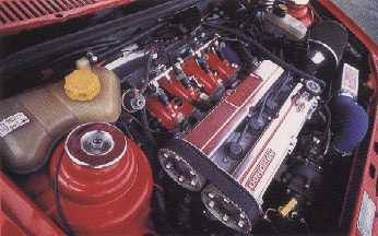

Fiesta Frenzy 400bhp Turbo ZVH Engine
0-60 in less than 4 seconds, 1/4 mile 13 seconds, as featured in Ian Howell's RST, Performance Ford, Aug 1998.
406bhp Mad...
Two litre Zetec SE, DOHC 16v bored to 2.1 litres. Mahle forged, low-compression pistons with Teflon skirts, Carillo con rods with ARP big end bolts, custom-profile Kent FZ1802 cams with vernier pulleys, lightened and balanced clutch, crankshaft and flywheel assembly. Gas-flowed, ported and polished cylinder head with large inlet valves, de-shrouded, knife-edged inlet ports, Raceline inlet manifold and custom ally plenum chamber with integral bell mouths. Jenvey 45mm throttle bodies, reshaped combustion chamber for low compression. Sodium filled exhaust valves with port face adapted to fit S2 Escort RST exhaust manifold, T3.5 hybrid turbo with 360' thrust bearing, Escort Cosworth inlet housing, Volvo (er..) Turbo wastegate housing and Garrett -31 actuator, Bailey Motorsport DV25 dump valve and 0.63AR exhaust housing. (pause for breath...) Pace custom chargecooler, polished cam cover. Weber-Alpha ECU and wiring loom, Bosch 400 blue injectors, 3bar map sensor. Pipercross Sapphire Cosworth cone filter, custom 3" downpipe and exhaust system with Scorpion silencer box and DTM-style twin upswept tail-pipes. Standard five-speed 'box with adjusted gear ratios, AP Racing paddle clutch.
Cost: If you have to ask...
