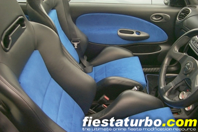

James' "Neil's Auto
Interiors" retrimmed Turbo. Mk4 dash and door
cards, leather and alcantara Recaro SR seats. See James'
site at http://www.fiestas.mcmail.com
for more information. |
